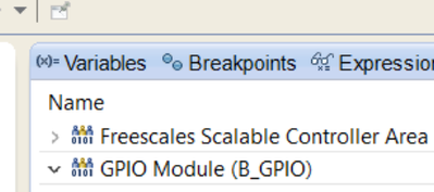

I'am programming MM9Z1_638 microcontroller. I set output and input PORTA, but i don't set input GPIOB.
I wrote this function:
void GPIOB_Init(void)
B_GPIO_CTL = (B_GPIO_CTL_PE1M_MASK |0);
B_GPIO_CTL = (B_GPIO_CTL_PE2M_MASK |0);
B_GPIO_CTL = (B_GPIO_CTL_PE3M_MASK |0);
B_GPIO_CTL = (B_GPIO_CTL_PE4M_MASK |0);
B_GPIO_CTL = (B_GPIO_CTL_DIR2M_MASK|0);
B_GPIO_CTL = (B_GPIO_CTL_PE2M_MASK |B_GPIO_CTL_PE2_MASK);
B_GPIO_CTL = (B_GPIO_CTL_DIR3M_MASK|0);
B_GPIO_CTL = (B_GPIO_CTL_PE3M_MASK |B_GPIO_CTL_PE3_MASK);
and i wath B_GPIO register and B_GPIO_CTL register is 0x0000.
Why cant i set port and how can i use this port?

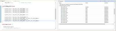

Hello StanoA,
I tried the way you said but it is not work.
My init function:
Not: I want to use input GPIOB pins.
B_GPIO_CTLH = (B_GPIO_CTLH_PE1M_MASK | B_GPIO_CTLH_PE2M_MASK | B_GPIO_CTLH_PE3M_MASK | B_GPIO_CTLH_PE4M_MASK
| B_GPIO_CTLH_DIR1M_MASK | B_GPIO_CTLH_DIR2M_MASK | B_GPIO_CTLH_DIR2M_MASK);
B_GPIO_CTLL = (B_GPIO_CTLL_PE1_MASK | B_GPIO_CTLL_PE2_MASK | B_GPIO_CTLL_PE3_MASK | B_GPIO_CTLL_PE4_MASK);
After the work, B_GPIO_C register value is 0x0000.

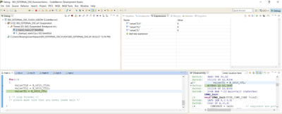

Please reset the MCU in debug mode, set the breakpoint to line “for(;;) { …” and run the code. When it will stop on breakpoint read the variables:
value and value2.
This means select them in window:
And check the values.
Stano.

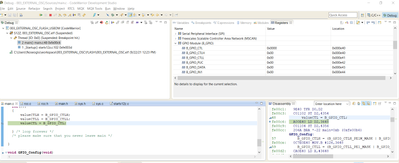

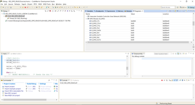

Hello StanoA,
I reset mcu in debug mode and set break point in for loop, i see the all values is 0.

I asked our specialist for help. The result is:
The port bit must be written together with their mask bit = 1.
If the associated mask bit = 0, the write is not allowed.
The masked bits (e.g. GPIO...PE1M and GPIO...PE1) have to be written in a single access. In this case as 16bit write. Please see the attached gpio.h file also for this example:
// enable PTB1 as output
B_GPIO_CTL = GPIO_CTL_PTB1_ENABLE | GPIO_CTL_PTB1_OUTPUT;
B_GPIO_OUT1 = OUT_PTBx;
// set PTB1
// clear PTB1
B_GPIO_OUT1 = 0;
Please see also this AN for this product:
https://www.nxp.com/docs/en/application-note/AN12301.pdf
I hope it could help you with your task.
