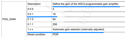

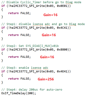

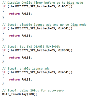

          I am working with MC33772 ADC2 current.  Debug situation is injecting 390A current under room temperature and ADC_CFG is initialized by 0x093F.  I found that MC33772 gain became 256 occasionally when using GPIO5-6 as inputs to the current sensor PGA with entering into diagonostic mode although gain is set fix 16. As below is procedures of entering into diagnostic mode. Is it correct? what is root cause why MC33772 gain became 256? Looking forward to your reply.

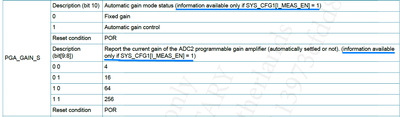

please refer to the section 9.6, page 37. in the MC33772C datasheet. The PGA gain can set to fixed gain in the ADC_CFG register, address 0x06, bits [10:8] PGA_GAIN.

         Thanks for your reply. I am sure that MC33772 is not in sleep mode. I never SPI to  SYS_CFG_GLOBAL to go to sleep mode. I found that fixed gain becoming 256 ocurred only when enable isense adc in diag mode. As below is procedures of entering into diag mode. Looking forward to your reply.

I have checked the piece of code you have shared and it is correct. I see you have set I_MEAS_EN bit to 1, in SYS_CFG1 register $03, which is needed to be able to read the PGA_GAIN_S value.
Could you please share the code line, how you set the PGA_GAIN to fixed value? And also the code line how you recognize the PGA_GAIN value? I presume you set the PGA_GAIN in the ADC_CFG register $06 and you also check the PGA_GAIN in the same ADC_CFG register $06? Please share the reading value of the ADC_CFG register $06.
