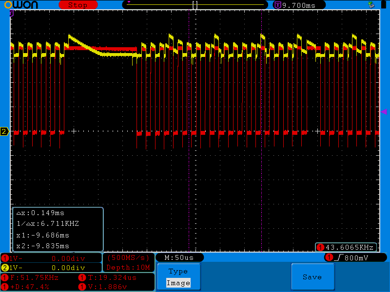

I am trying to implement MAG3110 to my project and I have already communicated with the device and read the register contents. I am also reading ZYXDR bit successfully of which I can see that it changes. The datasheet says that this bit is logically connected to the interrupt pin but the interrupt pin doesn't change.
I am using FRDM-KL25Z to interface the sensor. I have connected the interrupt pin of MAG3110 to NMI pin. Also, for test purposes I have left this pin floating but nothing changes. It is always HIGH.
Here is my code:

Hi Abdullah,
After reviewing your layout and looking at your board, I guess I found where the problem is. It looks like you accidentally swapped both INT1 and VDDIO pins, having the INT1 pin (#9) connected to VDD and VDDIO pin (#8) to INT1. You will have to modify your layout or cut the traces at those pins and use wires to connect them properly.
I hope this helps.

abdullahkahrama
As you can see, my code is basically yours, already. I have copied your routines and such :smileyhappy:
I have downloaded your project files and changed it to use I2C0 instead of I2C1 and still, the result is the same. I cannot see any LOW level on interrupt pin after power up. When I check it with the oscilloscope, it just jumps to 3.3V and stays like that. Then, after about 4ms, KL25Z  starts the data transfer and successfully communicates, but still, nothing changes on the interrupt pin.
According to what you say about the behavior of MAG3110, even if there is no MCU controlling it, there should be a low pulse of 500ns after POR. But I can see no change at all.

abdullahkahrama
I am using my own homemade board and I will try to change the part now. Maybe I was not able to solder it properly. Below is my schematic.
4,696件の閲覧回数
abdullahkahrama
I have changed the PCB and the MAG3110 with new ones, and this time INT pin goes down to only about 3 volts. Below is a photo of the PCB and a screenshot of the oscilloscope. CH1 (red) is I2C_CLK and CH2 (yellow) is INT pin while it is floating. When I connect INT pin to KL25Z's pin that is configured as input and NMI, the peak to peak value of the squarish wave gets reduced by about 100 times, so it basically almost 3.3V with little fluctuations on top.

TomasVaverka
Hi Abdullah,
I hope this helps.

abdullahkahrama
Hi Tomas,
Oh, wow, that is very shame of me :smileysad:
Thank you for your very kind help.
