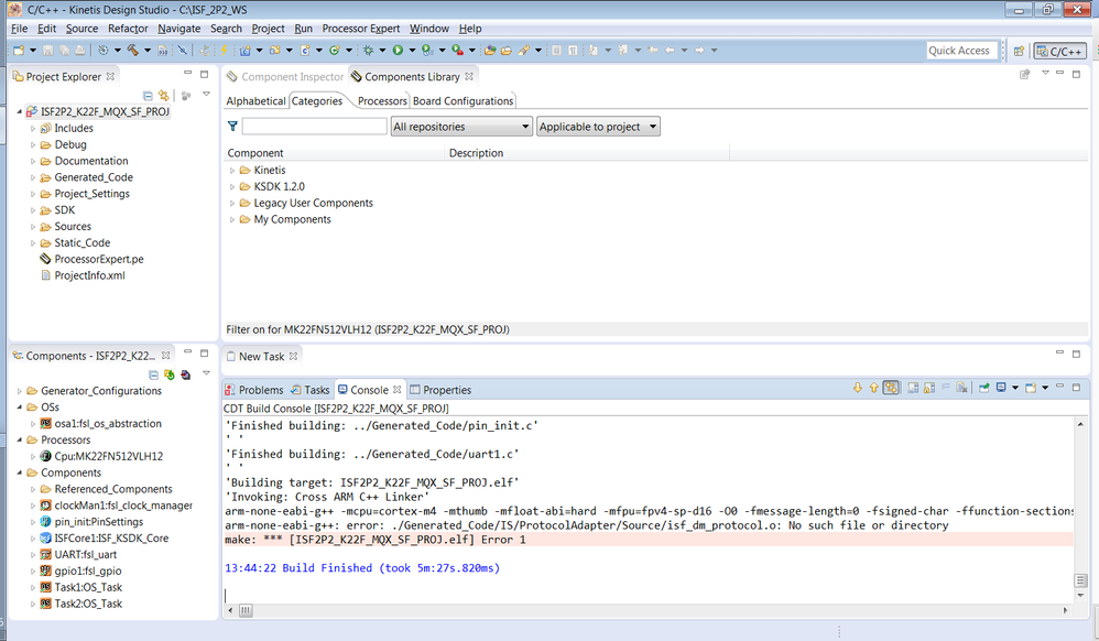

I imported the example application from there but I still get a linker error. This time:
So I did a "clean" and a "refresh", re-generated Processor Expert Code, and did a build but no change. Same Linker error.
I will try re-booting and report back on any changes. Maybe I'm having memory issues with too many programs open.

davidmunsinger
Hi Mark,
This is your problem, I'm about 90% sure.
Try navigating (inside KDS 3.x Import Existing Project) to here:
Try the project from this location and I bet it will work.
Dave...

davidmunsinger
Hi Mark,
I think you may have leftover projects from previous versions of ISF 2.2.  We have just released a new ISF 2.2 Installer (3/4/2016), so please check that.  I did the install fresh this morning.  The corresponding project (build) should look like this:
Please check the installation and make sure you are importing ISF2P2_K22F_MQX_SF_PROJ.
thanks!
Dave...

marks
Hi Dave,
I think you are on to something with your suggestion about "make sure you are importing ISF2P2_K22F_MQX_SF_PROJ".
Is it possible the older file is posted the on web?
On 3/21/2016 I downloaded a file called ISF2P2_K22F_MQX_SF_PROJ.zip.  I created a work space called ISF_2P2_WS and put the .zip file in there and un-zipped the file.
Notice that the project folder starts off with ISF_K22F... not ISF2P2_K22F...
In your screen shot above your project name starts with ISF2P2_K22F.... My project starts with ISF_K22F... Screen shot below.
Why the difference between my project name and yours?
Please download ISF2P2_K22F_MQX_SF_PROJ.zip off the NXP public web site and you'll see what I mean.
