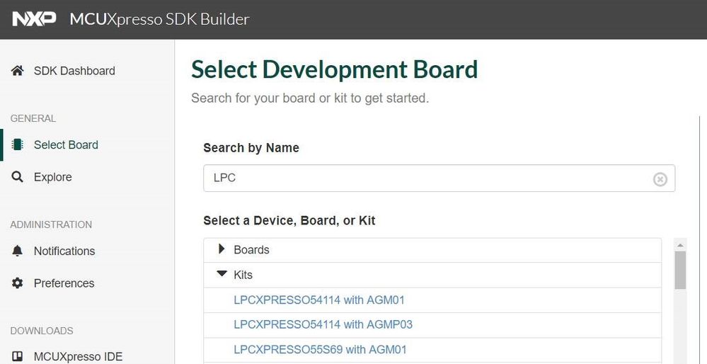

The binaries available as part of File -> Flash LPCXpresso Binary options in the NXP Sensor Fusion Toolbox were custom made for Sensor Fusion Toolbox v5 (older version) compatible with KSDK v1.2 using the Processor Expert module on Code Warrior toolchain (Kinetis SDK v1.2 is no more available). I do not have the source code or Code Warrior project for this binaries since latest Sensor Fusion Toolbox v7.x is integrated into ISSDK and is compatible with MCUXpresso SDK v2.5.0 (latest version). Even MCUXpresso SDK builder does not support the LPC families listed in the Sensor Fusion Toolbox File -> LPCXpresso Binary tab (i.e. LPC4337, LPC1549 and LPC11U68). The MCUXpresso SDK builder only supports LPC5xxxx and LPC8xxx series of MCUs:
So I would recommend to use these LPC MCU families supported by MCUXpresso SDK latest version (since support model will be sustainable) and the ISSDK based Sensor Fusion examples we have for the following LPCXpresso boards:
