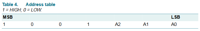

The LM75A slave address on the I2C-bus is partially defined by the logic applied to the device address pins A2, A1 and A0 as below:
So, the 0xFF Is not a valid address for the device.

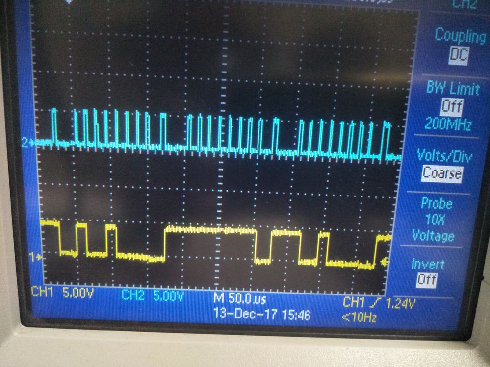

saurabhsaxena
Hi David,
Please find below the give waveform, here we are performing a write operation A0-A2 are all zero, the bus is left open and sensor samples the pointer address during the time and a ACK can be seen on the 19th Clock.
I hope this helps this is the best I can get now, its clear during the 19th clock the bus is grounded by Sensor as ACK.
I have lost my old DSO, hope it helps.
