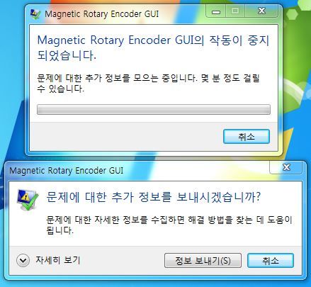

However, your attached file is not run on the Windows 7, 10 with below message.
Pls more check it.
Kyoungshik

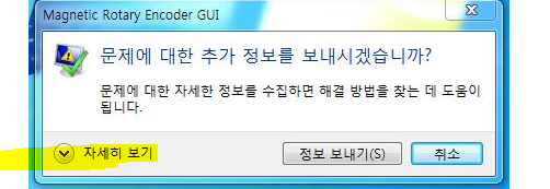

I would appreciate if you can translate the error message to english. Is is important to expend the message by clicking on
pastedImage_1.png.
Once you give me the right information, I could try to fix the issue.
Anthony

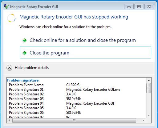

Below is extended message.
Problem signature:
  Problem Event Name: CLR20r3
  Problem Signature 01: magnetic rotary encoder gui.exe
  Problem Signature 02: 3.4.0.0
  Problem Signature 03: 5819e34b
  Problem Signature 04: Magnetic Rotary Encoder GUI
  Problem Signature 05: 3.4.0.0
  Problem Signature 06: 5819e34b
  Problem Signature 07: 9c
  Problem Signature 08: 44
  Problem Signature 09: System.NullReferenceException
  OS Version: 6.1.7601.2.1.0.256.1
  Locale ID: 1042
  Additional Information 1: 1139
  Additional Information 2: 11390e4467927538beca19e6323dba42
  Additional Information 3: fa7a
  Additional Information 4: fa7a8b876e88322e99f4f08cb713d851
Read our privacy statement online:
  http://go.microsoft.com/fwlink/?linkid=104288&clcid=0x0409
If the online privacy statement is not available, please read our privacy statement offline:
  C:\Windows\system32\en-US\erofflps.txt
Kyoungshik

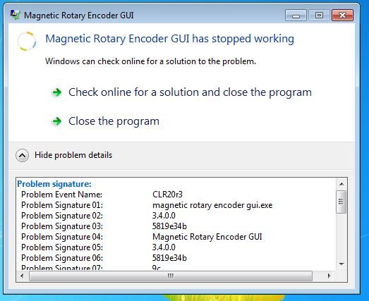

I need to localize the place in the source code where the error occurs on your computer. On my pc I don't see any issue at all; it may come from the system language. We never try the GUI on a Korean computer.
So I have generated for you a software debug revision with some additional message. You just need to copy the attached file at the NXP Magnetic Rotary Encoder software path (could be something like that: C:\Program Files (x86)\NXP\NXP Magnetic Rotary Encoder) and launch the .exe file. Let me know if you can see some pop-up and which one.
Anthony

Hello Anthony,
I got the same message.
Problem signature:
  Problem Signature 01: PKEBMICR10FCFYTS1R10K4RCKFN205HV
  Problem Signature 03: 5a5f1abf
  Problem Signature 06: 5a5f1abf
  Locale ID: 1042
Do you need to install other programs before installing this program?
Could you send me the original source if possible?
I can debug.
Kyoungshik

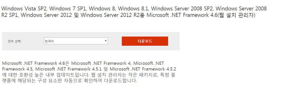

It is normal to have the error again, as I didn't identify the issue. But I added some pop-up in the execution like below to have a trace:
Can you check if you have installed the .NET Framework package 4.0?
Download Windows Vista SP2, Windows 7 SP1, Windows 8, Windows 8.1, Windows Server 2008 SP2, Windows ...
