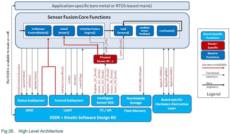

Hi Mason,

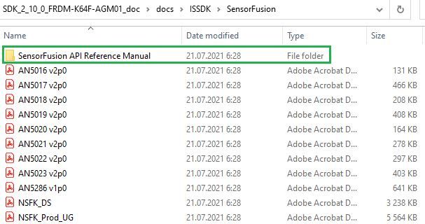

As far as I know there is no porting guide available for the sensor fusion library. However, you might find useful a user guide that provides high level architecture as part of section #4 (see snapshot below). Also it provides details of various sub-systems and functions along with data structures.
You can also refer to available sensor fusion library documents (API reference manual etc.) by downloading supported sensor kits SDK from https://mcuxpresso.nxp.com. Providing below a snapshot of SDK documentation for the FRDM-K64F-AGM01 kit where you can find sensor fusion library documentation:
