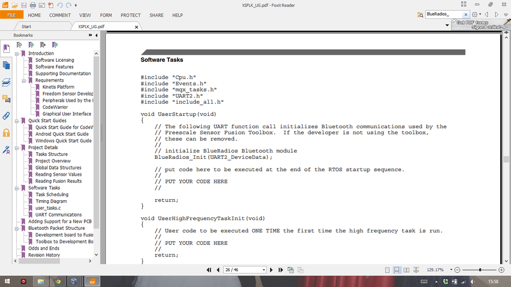

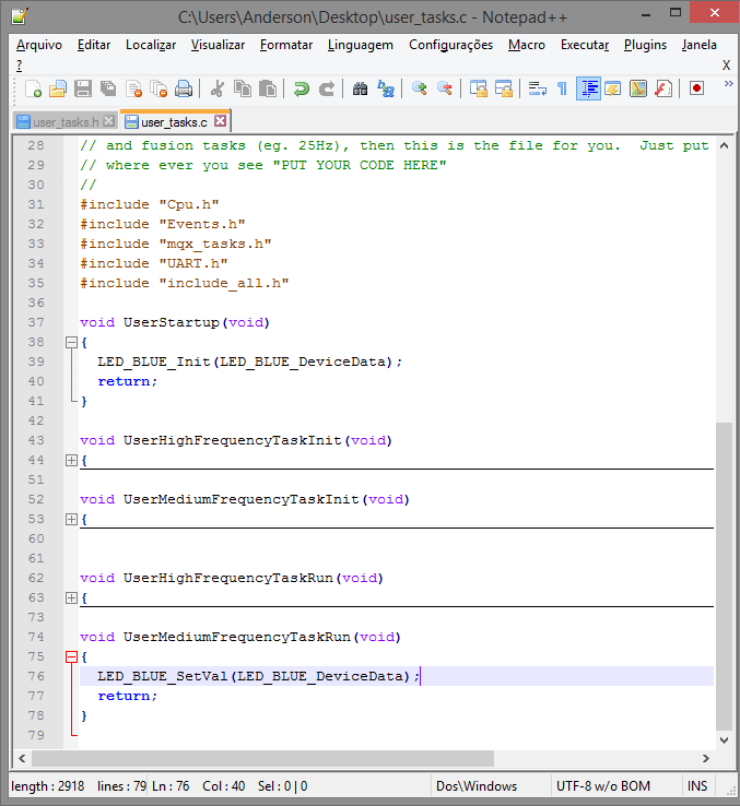

My problem is, I'm new in SFL, and I don't know how to use the user_task to write my application using the SFL. By the documents I need to change the user_task.c, putting my code there.

But, when I remove the codes and put anything like,  from example, nothing happens.

3,688 次查看
michaelestanley
Anderson,
Look at mqx_tasks.c, which toggles LEDs.  Examples include:
// switch the red LED on (line low sets LED on)
LED_RED_ClrVal(NULL);
LED_GREEN_SetVal(NULL);
LED_BLUE_SetVal(NULL);
If you try to set them elsewhere, you probably want to remove them from their current positions.
Mike
