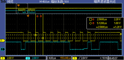

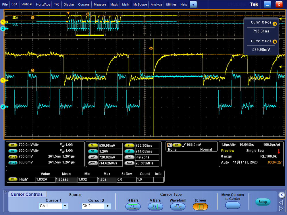

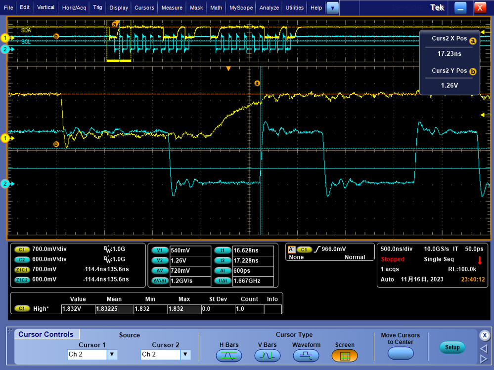

Hello, I want to implement communication with P3T1755 based on I3C bus. At the current 12.5Mhz frequency, the FPGA sends a 7E/W broadcast command, and the slave device responds with an NACK. Could you please tell me what to do? I3C waveform diagram is as follows:

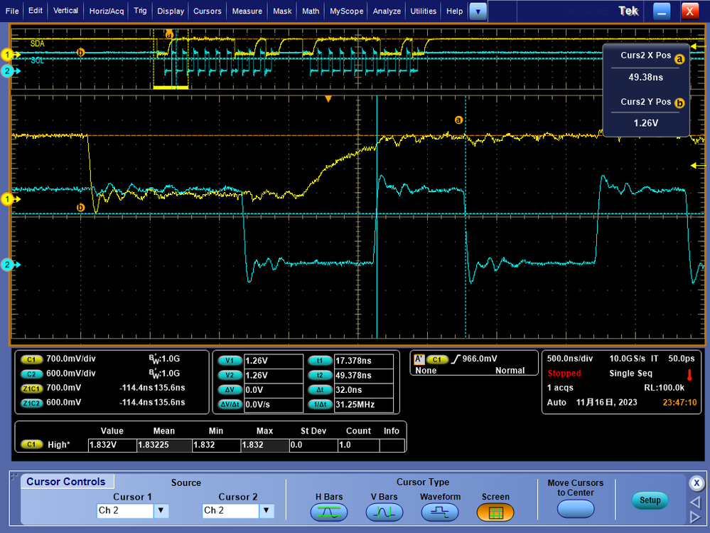

 The device is ACKing the first byte now.    The ACK is the portion where the low level voltage is slightly above ground.   I believe the issue is in your controller code.   You need to generate an ACK_HOLD  which keeps the ACK bit low after the rising edge of SCL.     Our design is an FPGA based implementation.   I am tasked with writing the C++ code that interfaces with the FPGA.    The FPGA code is generated by a outside contractor and I do not have access to the Verilog source.   The contractor told me that I had to set an ACK_HOLD bit in the command register for this type of access.   After I did that,  then it started to work.    Before I set that bit,   my waveform was similar to yours.   The device ACKed, but released SDA on the rising edge of SCL.

The first cycle with the Reserved Byte of 0x7E is open drain.    I think you are clocking SCL too fast.    When in open drain mode, reduce the clock to something like 400KHZ.     I am working on the same part and it is ACKing me fine, but I clock it much slower.     Check the datasheet, I think the top frequency is 3.4MHZ in push pull mode and then VCC must be greater than 1.8V.   I don't have a scope attached.   Only a simple logic analyzer.   However,  I uploaded a screenshot of this transaction.     Notice that I can speed the clock up fast for the next byte which is the Common Command Code since it is push pull.

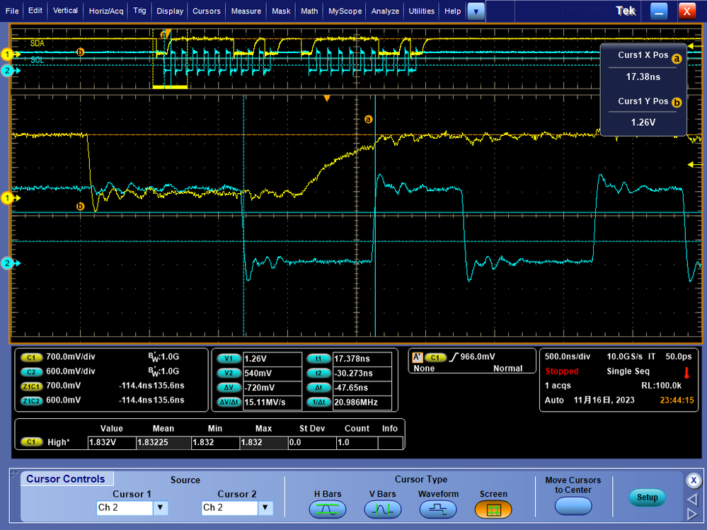

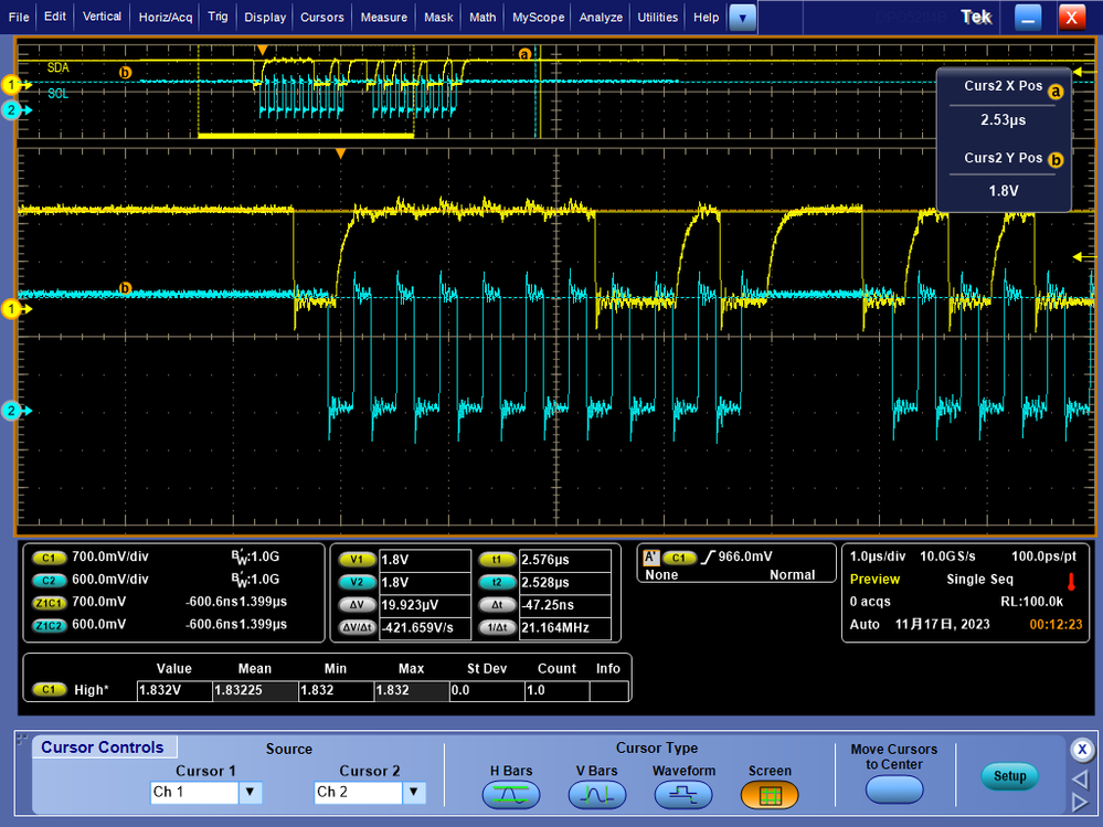

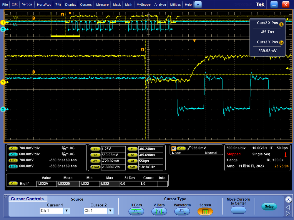

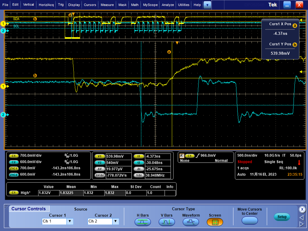

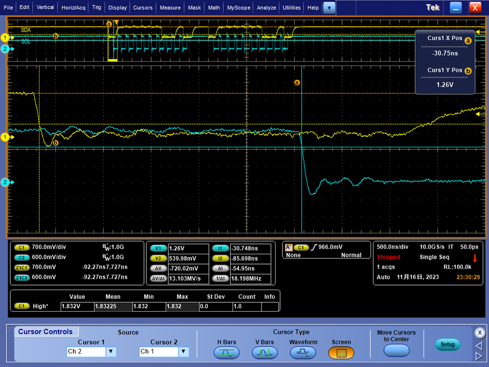

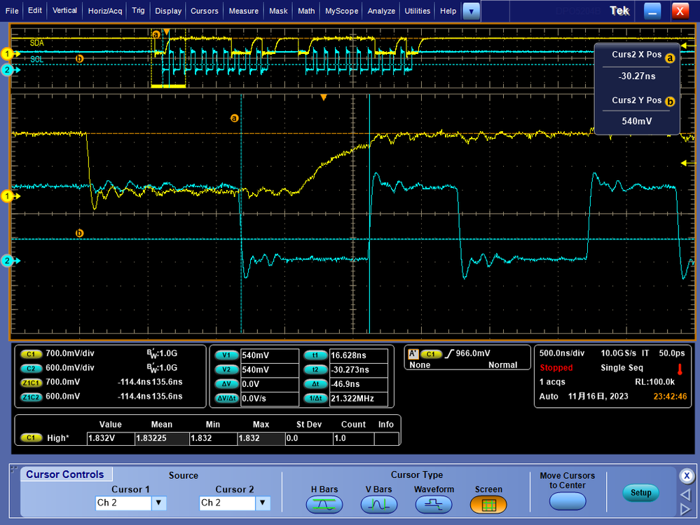

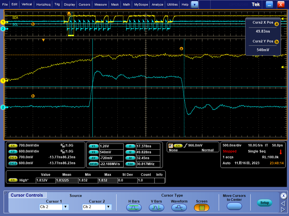

Hello, I have tried again according to your suggestion. I dropped the SCL frequency to around 400Khz and the VCC to 3.3V. But the results are still not good. Have I missed anything else that needs attention? The waveform diagram is as follows:
