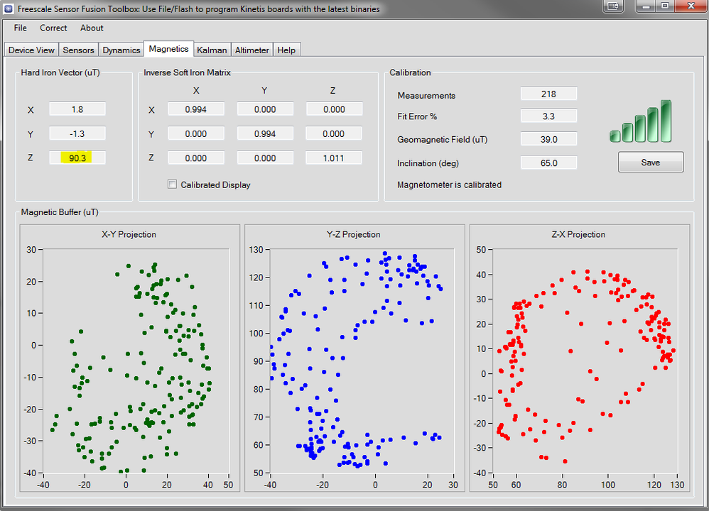

I am getting data from a FXOS8700CQ and the ranges are:
X: -160 to +200 uT
Y: -160 to +190 uT
Z: +35 to +350 uT
Are these accurate values? (I am in Santa Ana, CA if that makes any difference). Since the magnetometer only measures the magnetic field of the Earth, shouldn't the Z range also be -160 to +200 uT? Is there something wrong with the Z range?

anthonyduhamel
No, you don't need to use those features yet.
If you rotate the device around Z axis, the Z magnetic filed should not change significantly because the geomagnetic field is horizontal.
If you rotate the sensor randomly thought all axis you get:
Z measurements are always positive, because there is offset/bias, we called it "Hard-Iron". It's why we calibrate the magnetometer.
The sensor fusion ​will correct that.
Picture below displays the extracted parameters.
Anthony

anthonyduhamel
Anthony

tedhuntington1
Thanks Anthony,
So the reason the Z readings are all positive is because the particles in the Earth's magnetic field are creating a magnetic field (a so-called "hard iron source") in the copper in the PCB under the sensor? Or perhaps the hard-iron source is coming from a magnetic field from my computers that are in the same room? I may take a look at sensor fusion, I am running Linux but have Windows too, I'm not sure how I can import my data into sensor fusion (perhaps comma or tab delimited?)- or possibly I will just subtract a hard iron offset of 19- to bring Z into -16 to +16, and X,Y would be -2 to bring it to -18 to +18.
Ted
940 Views
anthonyduhamel
Ted,
Hard-Iron comes from permanently magnetized components located on the pcb plus magnetometer imperfections. I suggest you to read AN4247 & AN4246 (files attached) for furthers information on hard-iron distortions.
Yes you can subtract the hard-iron vector to the raw measurement vector to remove the bias but be careful about "static" calibration. Hard-iron vector can shift over time due to temperature changing, external magnetic fields disruptions coming close to the sensor and sensor position changes.
FYI, FXOS8700CQ comes with a self magnetic calibration feature (m_acal field to set in M_CTRL_REG1 plus m_raw field to clear in M_CTRL_REG3).
Anthony
