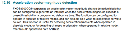

JozefKozon
Hello Igor,
for your case, I think the best would be the "Acceleration vector-magnitude detection". Please refer to the section 12.10 in the FXOS8700CQ datasheet and to the AN4692.
With Best Regards,
Jozef
