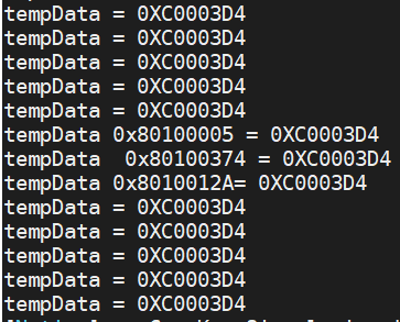

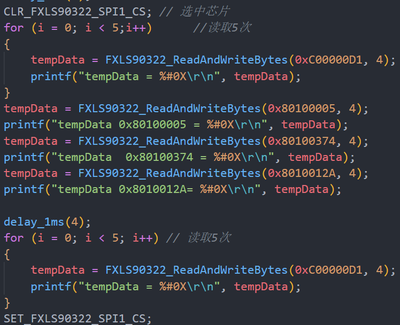

AIRKernel
Hello Jozef ,
We also met this problem.
We followed the commands in this pdf file , but we got the response "0XC0003D4" after sending erery commands.
That was strange.Please help us to solve this problem .
