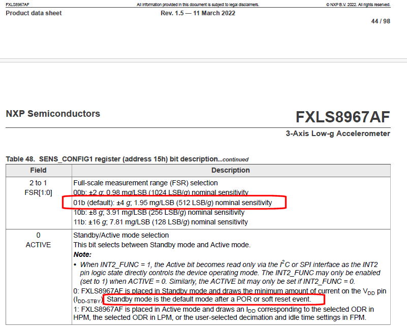

The current datasheet listed on the website is Rev 1.5 of Mar 11, 2022:
https://www.nxp.com/products/sensors/accelerometers/2g-4g-8g-16g-low-power-12-bit-digital-accelerome...

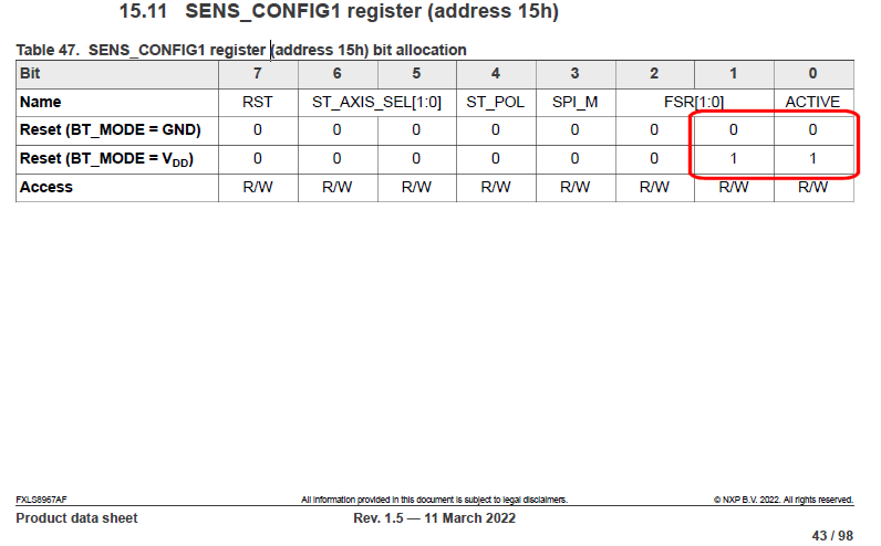

Table 47 shows that the SENS_CONFIG1 register default value depends on the BT_MODE pin:
This affects the FSR and ACTIVE fields.
The Table 48 descriptions fail to mention this, and use inconsistent options for the 2 fields:
  1. The description of FSR uses the BT_MODE=VDD default value, 01;
  2. The description of ACTIVE uses the BT_MODE=GND default value, 0

Hello andrewneil,
I hope all is great with you. Thank you for using the NXP communities.
Correct, I also think that Table 48 doesn't mention this. It is not clear.
I just wanted to let you know that I have already shared your feedback with the corresponding team. Thank you very much for your comments.
