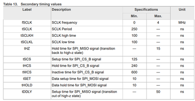

The device supports SPI interface with clock frequencies up to 4MHz. Could you please review the table below? Are you within the SPI timing specification?
How many devices have you tested and failed?
Can you share your device configuration (schematic)? Is the INTF_SEL pin pulled to VDD?
Could you please share the procedure that you use to configure the device using SPI?
