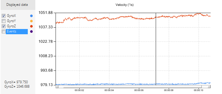

For the SelfTest
Please take a look at the table below. The value you have looks to be okay.
Anthony

3,632件の閲覧回数

I did a test with our RD-KL25-AGMP01 Datalogger board, recording data at 100Hz. I got pretty good results with the trapezoidal integration. I attached an excel spreadsheet if you want to look at the accuracy and formulas.
Thanks for info about Self-Test. I wasn't sure if it should be constant value.
Yes Karol, it should change each time. Take a look at the plots below:
                                             With Self-Test                                                                                                                                                      Without Self-Test
