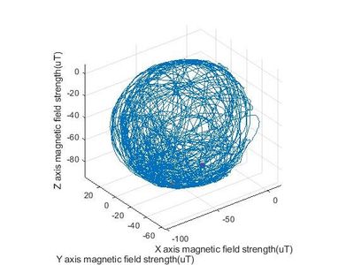

       My calibration process:Rotate PCB in 3D space, try to make magnetometer in PCB traverse each attitude.

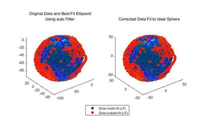

then the measured geomagnetic data will be the input of the calibration model of AN4246,then I can get Soft Iron matrix(A) and Hard Iron matrix(b).
Calibration ResultCalibration ResultSoft Iron Matrix and Hard Iron MatrixSoft Iron Matrix and Hard Iron Matrix
But in this calibration process,PCB and magnetometer is rotating together,the relative axis non-orthogonality between them have no effect on the measured data.No matter how the  magnetometer axis deviation from the PCB axis,the measured geomagnetism data will be the same ellipsoid.
       So I wonder if I misunderstand the calibration model in AN4246, or there is something wrong about my calibration process?
