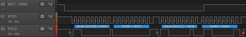

Deassertion of the INT1 pin after reading the STATUS register (0x00).
The auto acquisition time step is set in this example to the lowest possible value (1s), so the FIFO is read every ~32s.

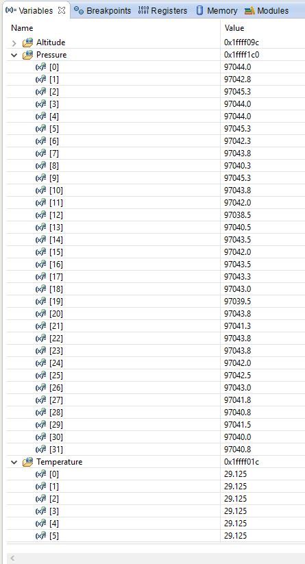

The calculated values can be watched in the "Variables" window on the top right of the Debug perspective.
