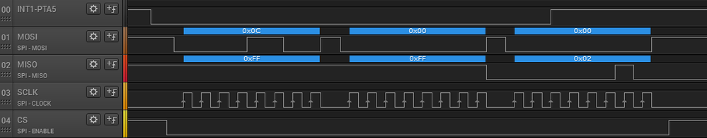

As I am often asked for a simple bare metal example code illustrating the use of the accelerometer vector-magnitude function, I have decided to share here one of my examples I created for the FXLS8471Q accelerometer while working with the Freescale FRDM-KL25Z platform and FRDM-FXS-MULT2-B sensor expansion board.
This example code complements the Python code snippet from the AN4692. The FXLS8471Q is set for detection of a change in tilt angle exceeding 17.25° from the horizontal plane. Once an event is triggered, an interrupt will be generated on the INT1 pin:

In the ISR, only the interrupt flag is cleared and the  INT_SOURCE (0x0C) register is read in order to clear the SRC_A_VECM status bit and deassert the INT1 pin, as shown on the screenshot below.
