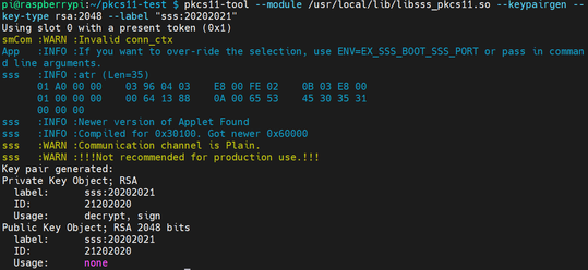

Kan_Li
Hi @user4 ,
Thanks for the information! I have tied the same with MW ver 4.5.1 , it just works as expected. Maybe you have to update the MW to the latest. Please kindly refer to the following for details.
Kan

Kan_Li
Hi @user4 ,
Kan
5,183 次查看
user4
Hi Kan,
Thank you for the inputs. I've also verified that using the libraries in that version does solve the problem, so will consider to ask the package provider to update the MW.
