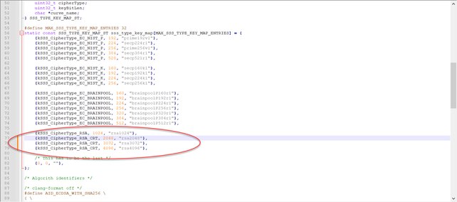

Hi @chanyoung ,
The openssl provider generates RSA in plain mode by default, which is not supported on SE050F, if you want to use provider to generates RSA CRT instead, just change the following kSSS_CipherType_RSA to kSSS_CipherType_RSA_CRT in sssProvider_main.h .
please also note RSA key length <2048 bits is not supported on SE050F either.

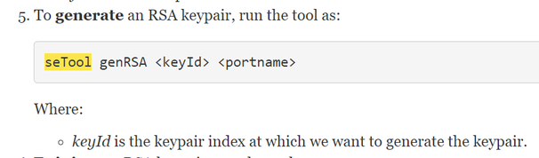

BTW, as provider doesn't support Key ID as a parameter, the default key ID is set as  "0xEF000011", but you may modify it in sssProvider_key_mgmt_rsa.c. Alternatively you may use SETool instead to generate RSA key pairs in SE050F.
Please refer to se05x_mw_v04.05.01/simw-top/doc/demos/se05x/seTool/Readme.html for more details.
