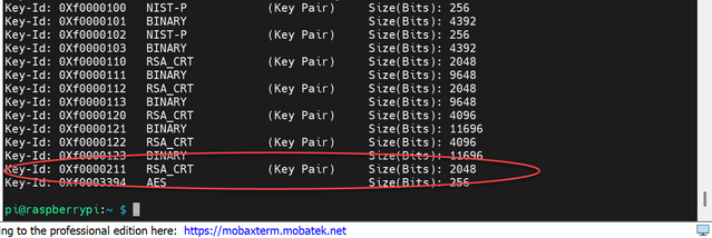

In addition, when I use OM-SE051 ARD-E Dev Kit to run seTool to set RSA key (using PlugAndTrust_v04.07.00_20250210), I get an error described as below image:

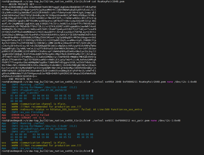

I built Plug & Trust MW version 04.07.00 and tried with SE051 but it still fails when using RSA key while succeeds with ECC key. Details are shown in the image below:

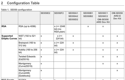

Are you using OM-SE050E-ARD ? Indeed SE050E doesn't support RSA.
