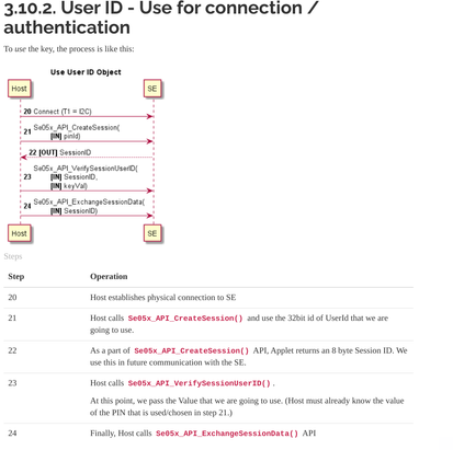

I am trying to open a Session using a UserID, which I created using Se05x_API_WriteUserID. As a starting point I am using demos/se05x/se05x_Minimal.c. Overall I use the following lines according to the documentation (see image):

means my session is created, but afterwards I get 6B00 which I can't find as error-code. Furthermore the documentation states that the sessionID shall be passed to VerifySessionUserID, but there is no parameter for it. Or should I somehow update pSession?

Actually there is a demo for this kind of application, it is based on SSS APIs. You may refer to simw-top/doc/sss/doc/apis-sss_session.html#se050-session for details.

Actually sss APIs are based on Se05x_API_xxx , but make the application easier to implement, for example, if you trace into sss_session_open(), you will finally reach at se05x_CreateVerifyUserIDSession() which shows how to make this approach work.
