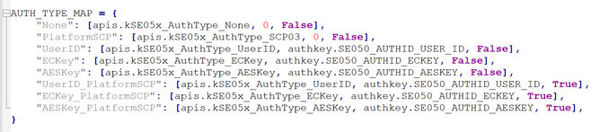

Taking opensslRSA.py as an example, could you tell me how would I be able to pass "auth-id" for opening a session.
Riz
10,860 Views
Kan_Li
Hi @Riz ,
Actually the example binds the auth_type with auth_id together as defined in const.py, where you may find the definition of AUTH_TYPE_MAP. so you needn't pass the auth_id as well, auth_type is enough, and you may refer to openssl_provisionRSA.py for details regarding opening a session , and of course you may extend the definition of AUTH_TYPE_MAP according to your application.
Hope that makes sense,
Kan

So in a nutshell what I understand is, if I want to enable user authentication based sessions in my application using openssl, I would first use session_open(...) as given in openssl_provisionRSA.py (which internally uses SSS APIs) to open an authenticated user session and then perform any sign/verify operations with openssl once session is established.
Is my understanding correct?
