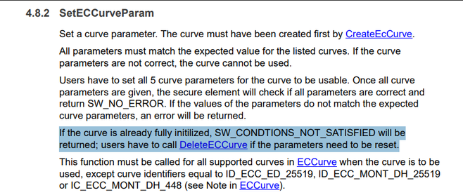

krsuresh
Hi @Kan_Li.,
I believe this issue began after executing the kSE05x_ECCurve_NIST_P384/ kSE05x_ECCurve_NIST_P521 sample. Based on the Plug & Trust full package, the se05x_Minimal and se05x_GetInfo examples are functioning correctly; however, the ex_ecc and ex_ecc_rsa examples are failing. Could it be that the secure memory has been locked? I am still able to perform Se05x_API_WriteBinary operations using the Nano package.
Kindly advise if there is any option to perform a complete reset of the SE050 device.

2) Key write failures
When I try to create or use curve NIST-P384, I get an error:
Se05x_API_CreateECCurve(&se05x_session, kSE05x_ECCurve_NIST_P384);
After this, all EC key write or key generation operations fail with:
Error in Se05x_API_WriteECKey
Even if I switch back to kSE05x_ECCurve_NIST_P256, the issue persists.
Currently, I am unable to perform any write operations on both of my boards:
* OM-SE050ARD
* OM-SE050ARD-F
It seems that attempting P-384 has caused all key write operations to fail.
Could you please clarify:
* Does SE05x fully support NIST-P384?
* Why are all write operations failing even after switching back to P-256?
* Is there a way to reset or recover the SE05x to a known working state?
Sureshkumar R

krsuresh
Hi @Kan_Li,
As per the latest Nano package code, the se05x_crypto sample works correctly for NIST-P384, but all operations for NIST-P256 fail.
If I change to NIST-P384 (curveID = 4), does this mean the chip will no longer support NIST-P256?
* Is this expected behavior on SE05x when switching from P256 to P384?
* Is there a recommended procedure to recover NIST-P256 operations if NIST-P384 has been used?

Hi @krsuresh ,
Thanks for the info! I can see  Se05x_API_SetECCurveParam had a 6985 error, which means the curve has already be set up , but might not set up correctly, so you can not set it up again , neither using it for create key pairs, so please remove this curve at first. and re-run the se05x_crypto demo.
Please kindly refer to the following for details.
Kan

krsuresh
Hi @Kan_Li,
Thank you for the information. I have attempted to remove the curve using Se05x_API_DeleteECCurve, but I am still encountering the same 0x6985 error.
Could you please confirm if this is the correct procedure to delete a curve, or if I am missing any steps? Please find attached the debug log for your reference.

Kan_Li
Hi @krsuresh ,
Looks like you are using the api to generate ECC curve for nist384 to generate ECC curve for nist256, but keep the ECC parameters the same, so lead to this error, you have to use the parameters for nist256 instead.
#define EC_PARAM_prime256v1_prime \
0xFF, 0xFF, 0xFF, 0xFF, 0x00, 0x00, 0x00, 0x01, \
0x00, 0x00, 0x00, 0x00, 0x00, 0x00, 0x00, 0x00, \
0x00, 0x00, 0x00, 0x00, 0xFF, 0xFF, 0xFF, 0xFF, \
0xFF, 0xFF, 0xFF, 0xFF, 0xFF, 0xFF, 0xFF, 0xFF
#define EC_PARAM_prime256v1_a \
0xFF, 0xFF, 0xFF, 0xFF, 0xFF, 0xFF, 0xFF, 0xFC
#define EC_PARAM_prime256v1_b \
0x5A, 0xC6, 0x35, 0xD8, 0xAA, 0x3A, 0x93, 0xE7, \
0xB3, 0xEB, 0xBD, 0x55, 0x76, 0x98, 0x86, 0xBC, \
0x65, 0x1D, 0x06, 0xB0, 0xCC, 0x53, 0xB0, 0xF6, \
0x3B, 0xCE, 0x3C, 0x3E, 0x27, 0xD2, 0x60, 0x4B
#define EC_PARAM_prime256v1_x \
0x6B, 0x17, 0xD1, 0xF2, 0xE1, 0x2C, 0x42, 0x47, \
0xF8, 0xBC, 0xE6, 0xE5, 0x63, 0xA4, 0x40, 0xF2, \
0x77, 0x03, 0x7D, 0x81, 0x2D, 0xEB, 0x33, 0xA0, \
0xF4, 0xA1, 0x39, 0x45, 0xD8, 0x98, 0xC2, 0x96
#define EC_PARAM_prime256v1_y \
0x4F, 0xE3, 0x42, 0xE2, 0xFE, 0x1A, 0x7F, 0x9B, \
0x8E, 0xE7, 0xEB, 0x4A, 0x7C, 0x0F, 0x9E, 0x16, \
0x2B, 0xCE, 0x33, 0x57, 0x6B, 0x31, 0x5E, 0xCE, \
0xCB, 0xB6, 0x40, 0x68, 0x37, 0xBF, 0x51, 0xF5
#define EC_PARAM_prime256v1_order \
0xFF, 0xFF, 0xFF, 0xFF, 0x00, 0x00, 0x00, 0x00, \
0xFF, 0xFF, 0xFF, 0xFF, 0xFF, 0xFF, 0xFF, 0xFF, \
0xBC, 0xE6, 0xFA, 0xAD, 0xA7, 0x17, 0x9E, 0x84, \
0xF3, 0xB9, 0xCA, 0xC2, 0xFC, 0x63, 0x25, 0x51
#endif
Hope that helps,
Kan

krsuresh
Hi @Kan_Li,
Thank you for the clarification.
After applying the correct parameters, both the NIST256 and NIST384 ECC curves are now functioning as expected. Could you please provide the documentation or reference material related to the SetECCCurveParam procedure that you referred to? Having this information would help me better understand the required parameter settings and the underlying behavior.
