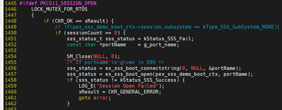

I am trying out TLS communication with openssl and Pkcs11-SSS library.
After a successful handshake, I observed that I was unable to send data from TLS server stdin to the TLS client.
Setup:
TLS server: Device with Secure element SE05X. Example command below.
OPENSSL_CONF=engine.conf openssl s_server -port <PORT_NO> -engine pkcs11 -keyform engine -key 1:XXXXXXXX -dtls1_2 -cert server.crt -CAfile rootCA.crt -cipher DHE-RSA-AES128-GCM-SHA256
TLS client: Regular Linux machine connected to it. Example command below.
openssl s_client -connect <IP_OF_SERVER>:<PORT> -dtls1_2 -CAfile rootCA.crt -cipher DHE-RSA-AES128-GCM-SHA256
Digging deeper I observed that the file descriptor 0 (stdin) was closed by the pkcs11-sss library which was then used for connection with access manager. Due to which no input was read from stdin.
See code snippet below.
File: sss_pkcs11_pal_core.c
There are no comments near the code that would explain why this is being done.
Can you please look into this?

I tried looking into the code further, below is my observation.
The SM_Close(NULL,0) call from within the sss_pkcs11_pal_core.c is closing fd "0" even though there is no prior connection to the Security module.
This is because the "pSockCtx->sockfd" is initialized as static so gets a default value of 0.
See below code for reference from smComSocket_linux.c line ~50.
typedef struct
    int sockfd;
    char * ipString;
} socket_Context_t;
static socket_Context_t sockCtx;
static socket_Context_t* pSockCtx = (socket_Context_t *)&sockCtx;
static U32 smComSocket_GetATR(U8* pAtr, U16* atrLen);
U16 smComSocket_Close()
    if (pSockCtx->ipString != NULL)
        free(pSockCtx->ipString);
    pSockCtx->ipString = NULL;
    close(pSockCtx->sockfd);
    return SW_OK;
I think adding a static initializer to sockfd (may be -1) and a condition to check if fd is valid before closing should fix the issue.
Let me know your thoughts.
