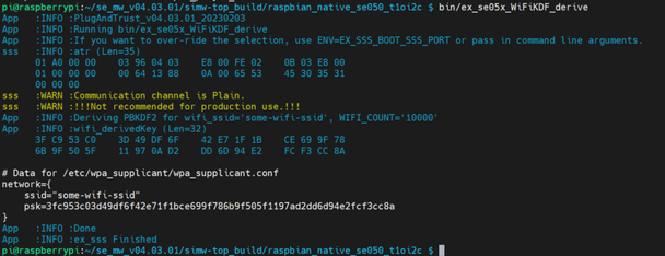

Hi all,
i tried the ex_se05x-WiFiKDF_derive example which allways fails on my SE051. Using this example with default ECKeys and an ECKey Session based on the rapsberry pi examples. I will attach the debug output.
I tried to call Se05x_API_PBKDF2 in the ex_se05_WiFiKDF_example on the raspberry pi.
App :INFO :Deriving PBKDF2 for wifi_ssid='some-wifi-ssid', WIFI_COUNT='10000'
it allways fails with:
sss :WARN :nxEnsure:'ret == SM_OK' failed. At Line:6992 Function:sss_se05x_TXn
App :ERROR:Se05x_API_PBKDF2 Failed
App :INFO :Done
App :INFO :ex_sss Finished
App :ERROR:ex_sss_entry Failed

Now its working but if i set the Count to 10.000 is not working with:
App :INFO :ex_sss_entry started
smCom :ERROR:phNxpEseProto7816_DecodeFrame Interface Reset to eSE wtx count reached!!!
App :INFO :Done
scp :ERROR: RESPONSE MAC DID NOT VERIFY 7042

I just got the solution from the expert team, and they suggested increasing PH_PROTO_WTX_DEFAULT_COUNT in simw-top\hostlib\hostLib\libCommon\smCom\T1oI2C\phNxpEseProto7816_3.h and this solution has been verified on my side. please kindly refer to the following for details.
In my test, PH_PROTO_WTX_DEFAULT_COUNT was updated to 1000, you may try it as well on your side.
Please kindly let me if the problem is still there.

Kan_Li
Hi @Tlabs ,
There is some issue with the policy of the symmetric key injected by ex_se05x_WiFiKDF_inject, so that it leads to the failure in WiFiKDF_derive example. Please apply the attached patch and try again.
Apply patch as
cd simw-top\demos
git apply ex_se05x_WiFiKDF.patch
Hope that helps,
Kan
