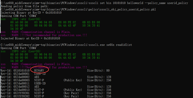

Just to re-iterate again: Se05x_API_WriteUserID() commented out because it fails - the ID exists. The second sss_session_open() in the code above fails with SM_ERR_COMMAND_NOT_ALLOWED.
So, my understanding is that ssscli does NOT work properly - it should never be used for anything. We do not know what it has done, but the required object ID is occupied. Could you please discuss it internally - I need to reset my SE050 to the state it had on arrival: delete everything except ORIGIN_PROVISIONED. Could you just give me some code that does it.

My fault, the ssscli tool can be used to open a session with some UserID but can not create a secure object as UserID, I messed them up, but anyway, this tool can be used to erase such kind of secure objects with the command line like "ssscli erase xxx", if you setup the policy properly, so I am wondering how you setup the policy for bin file at 7FFF0205, did you enable the delete option for the common policy , or for some Auth ID? Please kindly clarify.
As you mentioned, "Se05x_API_WriteUserID() commented out because it fails - the ID exists. The second sss_session_open() in the code above fails with SM_ERR_COMMAND_NOT_ALLOWED." I think the root cause is due to the bin file you created occupies the ID for RESERVED_ID_FACTORY_RESET while the bin file is not an Auth ID such as UserID/ECKey/AESKey, so you could not open a session with it to perform the deleteall command.
Hope that makes sense,
Kan

You tell me what kind of things have happened after this. What I can confirm with debugger:
Se05x_API_CreateSession(): SM_ERR_COMMAND_NOT_ALLOWED
Se05x_API_DeleteSecureObject(session, 0x7FFF0205): SM_ERR_COMMAND_NOT_ALLOWED
So, we are locked out, and I was wondering what my options are?
NB you can dump policy and see all nice things there, but they are all lies because ssscli can't even readIdList properly.
9,566件の閲覧回数

I am not sure if you have checked the ssscli help manual already, but ssscli set bin is used to set a secure object as Binary not UserID, that is the main reason your code can not run properly , the only way is to erase this binary file and create a UserID Auth object instead with the same id , but I am not aware of the policy you set for RESERVED_ID_FACTORY_RESET, so far you haven't provided any info regarding this topic. Would you please clarify?
Kan

Hi @psvz ,
The command to generate a policy for userid is ok ,but the problem here is the auth_obj_id in the end, in your case it is set as 7FFF0205, actually the auth_obj_id in the policy means the user who has the access rights specified in this policy, so in your case, only authentication object with id of 7FFF0205 can access the secure objects attached with this policy, but then you created a binary file with the same ID of 7FFF0205 and attached this policy, this leads to only this secure object can access itself, but as this secure object is a binary file which can not be used to open a session, because only UserID/ECKey/AESKey can do that, so the result is no one can access/delete this binary file which occupies the ID for RESERVED_ID_FACTORY_RESET forever
Normally we set the auth_obj_id as 0x00000000 for a policy, 0x00000000 here means all other users, so you can access the secure objects with this kind of policy in the default session. For example,
This kind of policy can also be assigned to a binary file:
but the secure object itself is always a binary file, not USERID. and since the auth_obj_id is set as all other users, we may delete this object in the default session.
The device on your hand can still work but just can not perform the deleteall command as the ID of  RESERVED_ID_FACTORY_RESET is occupied by a binary file which can not be erased. If you fell unhappy with that, you may submit a private ticket for warranty according to the following video :
