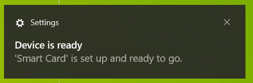

Thanks for the response. My question is more about as classic Smart card interface i.e. from PC/Laptop USB to K64F USB (over CCID) and K64F to SE050 over I2C interface. As per your response it looks this is possible. Please confirm.

Yes, you may use either of the following CCID examples out of the MW for evaluation purpose.
and after plugging into a Laptop, you will find the following notification.
Regarding how to program the bin file into the K64F-FRDM board, please kindly refer to "3.3 Flash FRDM-K64F with VCOM software " in https://www.nxp.com.cn/docs/en/application-note/AN12398.pdf for details.
