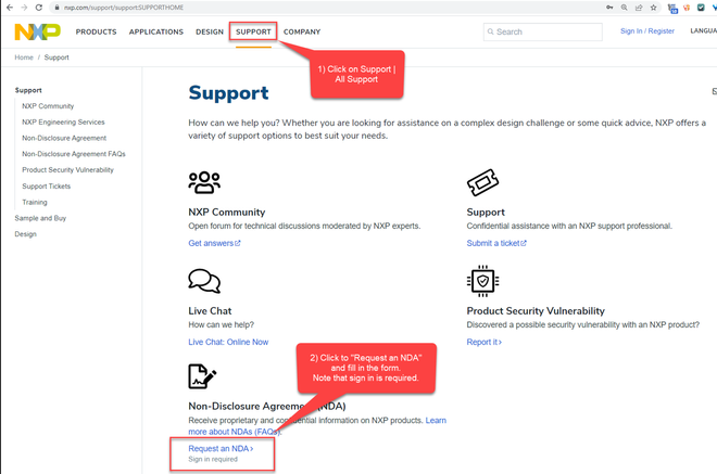

Kan_Li
Hi @hitesh_gambhava ,
The documents for P71 JCOP4 are under NDA, if you have not signed it with NXP yet , you may request it online, and then request them from the Secure File according to the following link:
https://www.nxp.com.cn/docs/en/user-guide/nxp-secure-access-rights-registration.pdf
and for commercial topic, please kindly contact your local NXP sales representatives.
Thanks for your patience and understanding!
Kan
