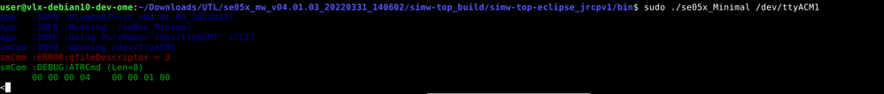

I'm trying to send apdu commands via Vcom to the SE050, when i use windows it work perfectly but when i compiled the examples in linux with all the correct parameters in cmake i got stuck like this:
I tried to debug and see if my serial ports are the problem but they work when i write and read data to them using simple C code with termios library, that sends an ATR command 00 00 00 00 and i got a correct response from the SE050.
So i wanted to know if there is not problems with vcom implementation for linux in the MW and is there functional examples for that?.
Thank you.

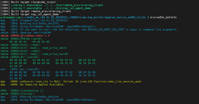

Hi @ninomedj ,
I just tested on a raspberry pi, with host set to PCLinux64 , and of course, smCom=VCOM, the demo works as expected, please refer to the following for details.
but when I tested with some older Ubuntu like 16.04 , I have the same issue as you met, maybe it is also your case?
Please kindly have my cmake options as below:

pi@raspberrypi:~/se05x_mw_v04.01.03_20220331_140602/simw-top_build/raspbian_native_se050_t1oi2c $
Hope that helps,
Kan

Kan_Li
Hi @ninomedj ,
From the snapshot, looks like you are using a building folder for eclipse for Linux compiling , please kindly refer to https://www.nxp.com/docs/en/application-note/AN13027.pdf and https://www.nxp.com/docs/en/application-note/AN12570.pdf for details regarding Linux building, and please use -DPTMW_SMCOM=T1oI2C for Linux building instead of VCOM.
Hope that makes sense,
Kan

ninomedj
Hi @Kan_Li
Thank you for your answer, i'm using linux on my computer VM, i dont want use t1oI2c because this is not an Embedded linux device , what i'm trying to do is to send APDU command to an MCU then the MCU forward it to the SE050 using VCOM, and it works using windows but not linux, so my qst is: is there a linux implementation for the vcom in the MW or not ?
Thank you and have a great day.

Kan_Li
Hi @ninomedj ,
Thanks for the clarification! Actually PCLinux has been tested already with the MW, and it works without any issue, so I am doubting if it is due to the VM, have you ever tried with a PC installed Linux natively? Is the problem still there?
Please kindly clarify.
BTW, would you please specify the building steps as well as the cmake options(you may fetch it with "cmake -L ." in the building folder)? looks like the building folder is not the right one.
Kan

ninomedj
hi @Kan_Li
Thank you for your answer again, No i didn't try with native linux setup, but i can confirme that the VM isn't the problem, right now im getting this errors:
App :INFO :PlugAndTrust_v04.01.03_20220331
App :INFO :Running ./se05x_Minimal
App :INFO :Using PortName='/dev/ttyACM1' (CLI)
Hope that helps,
Kan
