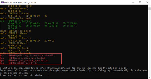

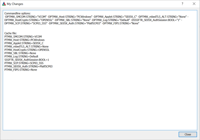

Kan_Li
Hi @ElielderBMelo ,
Since the dev kit still holds the default keys, so it should work with any demo code with Applet SCP03 Authentication enabled. Did you try it from your side?
To do this, you have to run cmake-gui . to enter the configuration view for cmake, and change the following options.
then configure and generate
and run cmake --build .
if you meet the following issue when running any demo,
please execute se05x_Delete_and_test_provision.exe at first to provision the Authentication Key.
With the default SCP03 keys, you may run any demo starting with an Applet SCP03 authentication like below.
If you run the demo following above steps, it means the dev kit on your hands should be ok, we should focus on the host application instead.
Hope that makes sense,
Kan

Hi @ElielderBMelo ,
Thanks for the information! I checked the cmake option from your side, almost the same, except the host.
I am wondering with which configuration you run the demo of "Delete and Test Provision"?
-DSCP=SCP03_SSS
-DSE05X_Auth=PlatfSCP03
Or
-DSCP=None
-DSE05X_Auth=None
As you mentioned before, the GetInfo demo can run well without SCP03 Authentication, so I think it should be the same the demo of "Delete and Test Provision", right? Please kindly clarify.
Kan

ElielderBMelo
Hi @Kan_Li
Thank you for checking my cmake options.
For "Delete and Test Provision" I'm using:
-DSCP=SCP03_SSS
I have shown in the document I have sent you the behavior with SCP03 authentication and without SCP03 auth. For you to help me to see if there is anything strange in the behaviour without SCP03 authentication.
