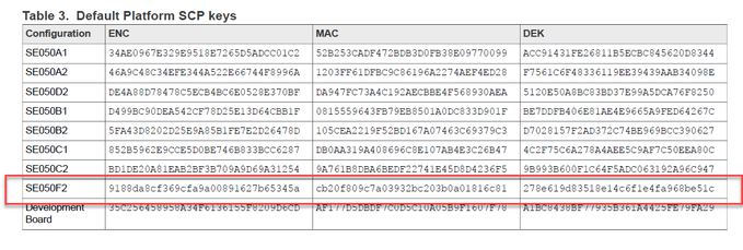

ElielderBMelo
I'm working with OpenSSL Engine + SE050 in a Embedded Linux. In SCP Authentication, I cannot initialize the device, when I reach:
// Verify whether the 8 left most byte of cardCryptogramFullLength match cardCryptogram
if (memcmp(cardCryptogramFullLength, cardCryptogram, SCP_GP_IU_CARD_CRYPTOGRAM_LEN) != 0)
status = kStatus_SSS_Fail;
cardCryptogramFullLength and cardCryptogram don´t match and I'm already using:
  • ENC is 35C29245895EA34F6136155F8209D6CD
  • MAC is AF172D5D54F7C0D5C10A05B9F1207F78
  • DEK is A2BC8438BF77015B361A4425F239FA29
They are set in file by the environment variable, by command:
EX_SSS_BOOT_SCP03_PATH=/home/root/plain_scp.txt openssl engine
By the end, I output the DEBUG in console, they presented as following:
scp :DEBUG: Output:cardCryptogramFullLength (Len=16)
B8 78 A9 C7 DB EE 3D 01 5A 5C 72 20 13 9E F2 74
scp :DEBUG: Output:cardCryptogram (Len=8)
27 C3 C1 F6 2D 0A E8 EA
Any solution? Why they don't match. I have attached console output.
Thanks!!!

Hi @ElielderBMelo ,
Thanks for the information! I have just checked with the expert, from the ATR info, looks like SE050F2 is on your board, and it uses different SCP03 keys as the default ones on the dev kits.
Please use the above keys instead and check if they make any difference. Please refer to https://www.nxp.com/docs/en/application-note/AN12436.pdf for more details.
You may also switch on FIPS option to make the MW built for the SE050F IoT Applet which is version 3.6.
of course it is not the root cause, but makes sense. It just slightly modifies the behavior of some examples.
Hope that helps,
Kan

Kan_Li
Hi @ElielderBMelo ,
Are you using the development board?
If yes, Did you change the SCP03 keys? Because our default keys are:
Please kindly refer to simw-top/doc/appendix/platfscp.html?highlight=scp03 for more details.
Kan
29,184件の閲覧回数
ElielderBMelo
Hi, @Kan_Li
Yes, I'm using the development board.
No, I'm using exactly this keys:
ENC 35C256458958A34F6136155F8209D6CD
MAC AF177D5DBDF7C0D5C10A05B9F1607F78
DEK A1BC8438BF77935B361A4425FE79FA29
Thanks.
29,141件の閲覧回数
Kan_Li
Hi @ElielderBMelo ,
Since the dev kit still holds the default keys, so it should work with any demo code with Applet SCP03 Authentication enabled. Did you try it from your side?
To do this, you have to run cmake-gui . to enter the configuration view for cmake, and change the following options.
then configure and generate
and run cmake --build .
if you meet the following issue when running any demo,
please execute se05x_Delete_and_test_provision.exe at first to provision the Authentication Key.
With the default SCP03 keys, you may run any demo starting with an Applet SCP03 authentication like below.
If you run the demo following above steps, it means the dev kit on your hands should be ok, we should focus on the host application instead.
Hope that makes sense,
Kan

sss :INFO :atr (Len=35)
00 A0 00 00 03 96 04 03 E8 00 FE 02 0B 03 E8 08
01 00 00 00 00 64 00 00 0A 4A 43 4F 50 34 20 41
54 50 4F
sss :INFO :Newer version of Applet Found
sss :INFO :Compiled for 0x30100. Got newer 0x30600

Thanks.

Kan_Li
Hi @ElielderBMelo ,
Hope that helps,
Kan

ElielderBMelo
Hi @Kan_Li
Thank you for the reply, it was successful. It worked and I ran the Get Info, Minimal and Delete and Test Provision applications with no more issues.
Now, I will continue the work to bind the library to the OpenSSL Engine.
Thank you a lot.
