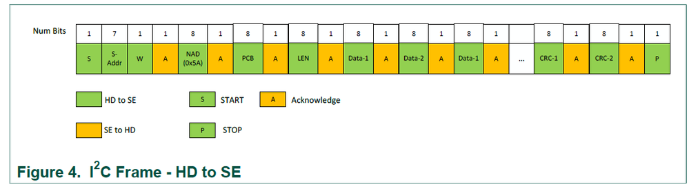

Kan_Li
Actually I could not find any obvious wrong in the packet values, maybe you can use some logical analyzer to probe the I2C frame, and check if it meets the spec as below:
Please kindly refer to https://www.nxp.com/docs/en/user-guide/UM11225.pdf  for more details.
Hope that helps,
Kan

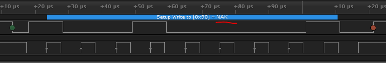

badhri_radhakri
Hi Kan_Li‌ thanks, I hooked up a logic analyzer and this is how my waveform looks like:
There is always a NACK after writing the Slave address which in this case is 0x48<<1.
Could there be any other mistake I'm making ? :smileysad:
Thanks!

Kan_Li
Are you using the SE050ARD board? are the jumpers set correctly? Please refer to https://www.nxp.com/docs/en/application-note/AN12395-OM-SE050ARD_hardware_overview.pdf  for details.
Kan
8,485 Views
badhri_radhakri
Thank you. The problem was with the ENA pin on the board. I wasn't paying attention to it's Jumper positions. Now I'm able to make the chip respond to my commands.
