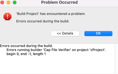

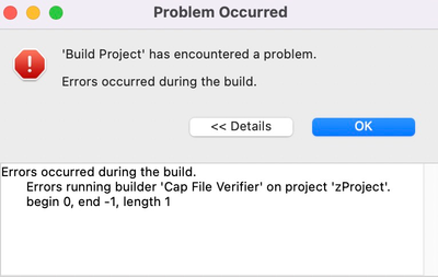

I built the project for a problem, as follows:
Errors running builder 'Cap File Verifier'

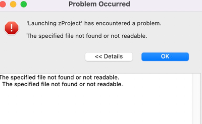

After the project is built, the cap file can be generated and running on the real phone, but I can not run the simulation of JCOP, have a problem as follows:
The specified file not found or not readable.
How can I resolve them?

I was just told that this CAP file verifier issue is a known issue indeed . It was fixed on the STAR build. Root cause is a Java version check which does not work in some cases. If you replace the attached class files from latest JCOP Tools plugin for STAR, where this issue was fixed, in your installed plugin, you should be fine. i.e., eclipse-java-2022-03-R-win32-x86_64\eclipse\plugins\com.nxp.id.jcop.eclipse_6.3.0.1\com\nxp\id\jcop\eclipse\internal\builder\VerifierBuilder.class and all VerifierBuilder related class files.

For the first issue, is it possible to share the building log? We may help to analyze where the root cause is.
For the second issue, actually if there is a problem locating the .cap file from the simulator, then it is some sort of script or command error. Not possible to address without a log to see exactly what the issue is, please kindly share it if possible.
If you are issuing some sort of upload <path to .capfile> command in the simulator. You have to check the path value.
If ,however, you have built the code in the simulator and are getting this error then it is likely the build has not been successful. You should open the ‘Problems’ window in Eclipse and look for issues.
Also, you can open the ‘CAP File Properties’ window. If that does not show valid .cap file sizes, meaning the build has not worked.
I notice you are talking about mobile here, if you are loading a .cap file built for mobile into the Smartcard simulator it will not work. Please share more information on simulator version also.

  There is not error when I built the project, only the box below pops up.
The cap is generated normally, the size is normal, and can be executed on the real phone, but when I run the simulator, the box below pops up:

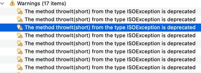

Is it possible to show the contents regarding the 17 warnings? I am wondering if they lead to this kind of issue.

    These warning should not lead to the error,  It's all the following warnings, which will not affect the compilation results.

Yes, I agree these warning would not lead to this issue. This kind of error would indicate that customer has chosen to use a Java API that in future will not be available.
So if for example the customer has built with JavaCard 3.05, a later version may not include this deprecated API and so in effect it is a warning that his applet may become unusable in the future.

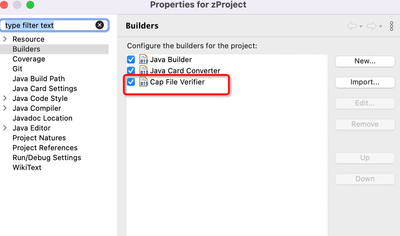

   When I built the project, it had a problem as follows:
I try to delete this option and the above problem will not be reported again, as shown below:
