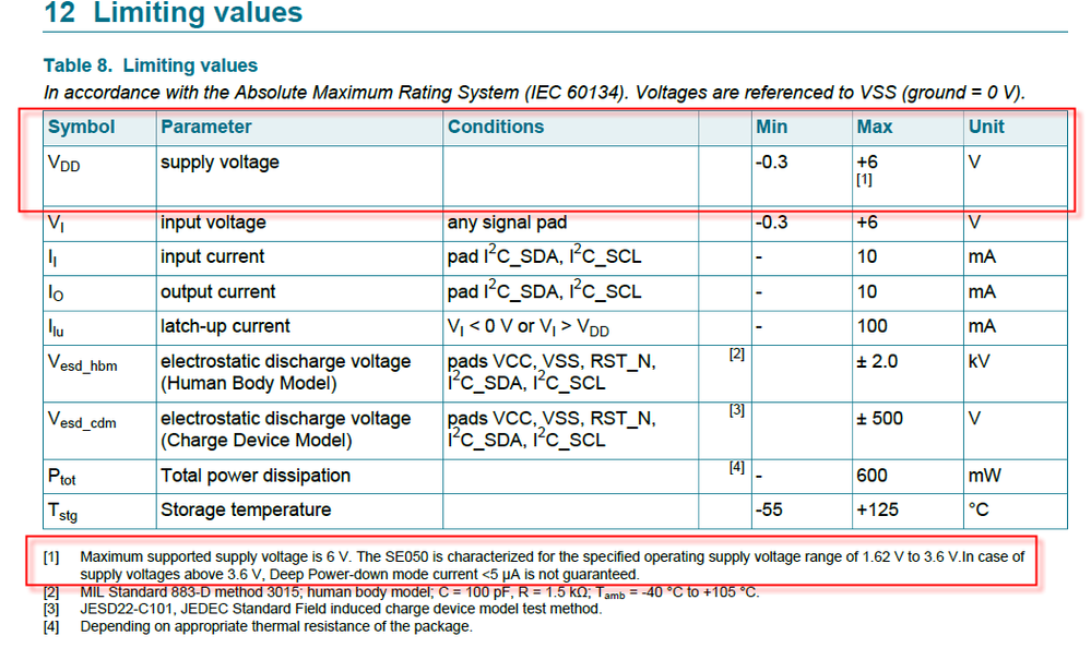

- In the data sheet under "14.1.3 Power consumption" the currents of the SE050 in the different operating modes are indicated. How high is the supply voltage for this information?

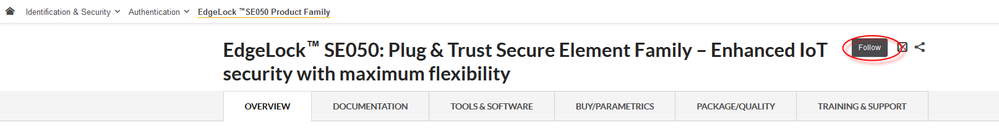

- The data sheet says that the SE050 also has a "MIFARE SAM functionality". But I didn't find any further information about it, neither in the datasheet nor in the application notes. When will more information on this topic be available?
- There will be a demo on this topic soon, please follow this product as below to get the notification when it is available.
-Please refer to the following for details.
