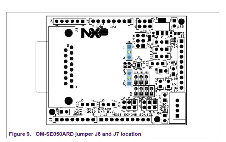

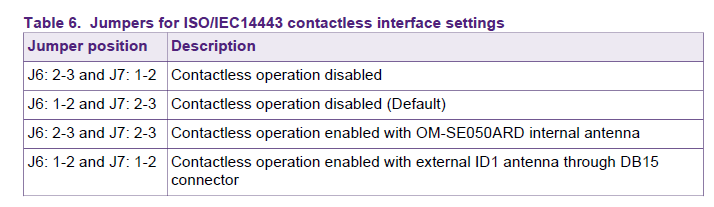

Yes, the Dev Board supports NFC interface via J6 and J7 jumper settings. Please kindly refer to the following for details.
 but to communicate with the SE050 via a Android Smartphone, you have to build a custom App to issue the SE050 APDU commands.

I am using a OM-SE050ARD,
I have set jumper J6 to 2-3 and J7 to 2-3.
I have installed the NXP TagInfo app version 4.25.4 on my Samsung smartphone (which can read other NFC tags).
However, when approaching the OM-SE050ARD antenna to the phone, nothing happens. Is this a problem with the smartphone app not sending the APDUS or do I need to program something into the SE050?
