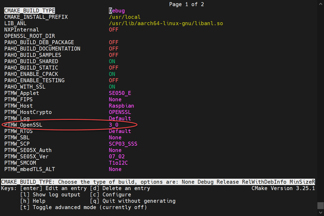

The former question got confused I think. There should be ccmake command - I just do automated installs, so I need to change that compile option from openssl 1.1.1 to 3.0. As you showed I can do it in interactive screen, but i' like to change it from a script. I'm new to cmake in general.

Kan_Li
Hi @psvz ,
For the compilation issue, I found the Pi OS has openssl ver 3.0.15 preintalled, so you have to configure the cmake option before building the MW. you may run "ccmake ." to do that.
The default value is still 1_1_1 here, so you will have warning during compilation.

psvz
Hi @Kan_Li
Thanks for this. Is there a way to change openssl version on command line to make it non-interactive?
