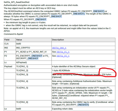

Hi @Changhawn ,
per APDU spec for AEADOneShot command:
When the AEADMode equals AES_GCM, the length of AAD + length of data should
be limited to 888 bytes - the total C-APDU buffer length. Did you meet this requirement?

The i2c issue was somewhat resolved by fixing the i2c access issue. However, the AEAD Decryption still has issues. Please check the code and logs to determine what the issue is.

By below SE050 specification, Oneshot input length is limited 256.
So I have developed with Multistep(AEADInit, AEADUpdate, AEADFinal). But still have problem.
That's low performance. It takes 95 secs. Could you recommand about this low performance.
Thank you.
Chang.
