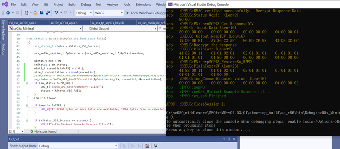

Hi @deang ,
I tried your code in the se05x_minial demo, it works just well, maybe the cause is due to the _se050_session_ctx was not referred correctly?

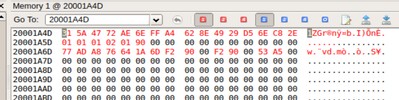

I did compare the two versions of Se05X_API_ReadCurveList(), one in Nano package and the other in full MW stack.  The only difference was calling DoAPDUTxRx() in Nano vs. DoAPDUTxRx_s_Case4() in full MW.  The main difference seems to be setting the LE byte in the request.  I tried forcing this byte on-off without any luck.  In the Nano package, the actual call is successful (DoAPDUTxRx() return SM_OK), but when the response buffer is parsed, tlvGet_u8Buf() returns 1, an error.  The response buffer looks incorrect.
Here's the response buffer (23 bytes) when the call fails (starting address 0x20001A4D):
On success here the response buffer (23 bytes):

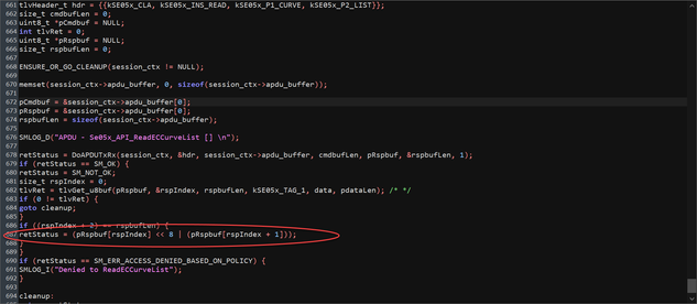

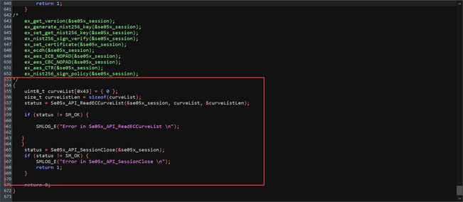

Kan_Li
Hi @deang ,
Thanks for the sharing ! I tried your code with the example of ex_se05x_crypto, and found a code issue as shown below, and it works well after fixing.
Hope that helps,
Kan

deang
That's not where the code is failing. tlvGet_u8buf() returns 1 vs. 0.  Digging further, inside tlvGet_u8buf(), the line of code failing is:
       if (got_tag != tag) { goto cleanup; }
The tag's incorrect b/c the response from the se050 seems garbled.  You can see the good and bad response in my previous post.

Kan_Li
Hi @deang ,
Actually I could not reproduce your issue here, in your code, if tlvGet_u8buf() returns 1, Se05x_API_ReadECCurveList returns SM_NOT_OK, and "Error in Se05x_API_ReadECCurveList \n" will be printed, but in my test, this debug info doesn't come out. Maybe you can try it again with this little fix?
Kan
