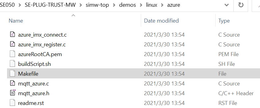

I'm trying following doc and stuck at step 3 of section 3.8 Register the device to Azure IoT Hub.
https://www.nxp.com/docs/en/application-note/AN12402.pdf
At the step 3 of section 3.8, it says that "Run the azure_imx_register script." but I can't find any script in /se050_mw_v02.12.00_20191125_120903/simw-top/demos/linux/azure folder.
Where can I get the script ?

Hi @ko-hey ,
It is not a script, but an application instead, and you have to compile the source code before fetching this application. Please kindly refer to the following for details.

Hi @Kan_Li ,
I understand that I need compile it.
To be honest, I'm not good at software so could you tell me how to compile it step by step ?

Hi @ko-hey ,
We provide a documentation on this topic, please kindly refer to SE-PLUG-TRUST-MW/simw-top/doc/building/imx6.html#imx6 for more details.
