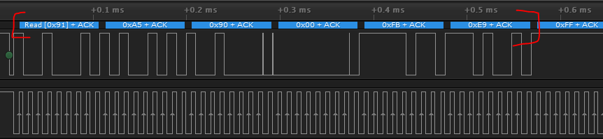

Hello team,
I'm performing an i2c communication between OM-SE050ARD (SE) and STM32F030R8 Nucleo (Master). I'm able to get the response. But whenever I perform an operation (say "Get_Version" or "Digest_OneShot"), I only get the Header part and the CRC as response. The actual response body is not displayed. My output is always seen as "A5, 90, 00, FB, E9". Is there any particular command I need to send for the actual response? Any leads would be much appreciated.

Kan_Li
Hi Elshadai,
1. As per my understanding, Lc field is used for the length of the payload. In this case we do not have a payload. So shouldn't we write Lc = 0x00 ?
 - Since no payload but Le is required, so you just need to specify Le here.
2. With the above values this is my trace and i only get 9000 but not the body. Before sending these commands I do a soft reset and read out the ATR bytes which works fine.
- Did you select the applet after ATR? Please kindly refer to 4.4 from https://www.nxp.com/docs/en/application-note/AN12413-SE050_APDU_specification.pdf  for details.
Hope that helps,
Kan

stephaniesmi606
I am a bit concerned with the level shift observed at high level at the moment the I2C starts. Are you sure that you correctly configured GPIO as open drain in the PIO controller of the STM32 ? walgreenslistens
14,708件の閲覧回数
genygbo
Hi bukiw nci,
Thanks for the comment. The GPIO is configured as open drain in STM32. The i2c trasmission is acknowledged well. Although, my concern is that I couldn't see the R-APDU body in my output. Trying to figure out the missing data.

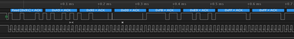

Kan_Li
Do you have the trace data for a review?
Kan
14,708件の閲覧回数
genygbo
Hello Kan,
Thanks for the reply. Kindly find the attached response seen when I try to call 'Get Version'.
This is the response I get when I also call other functions like digest one shot etc. I'm able to see the R-APDU trailer in the response but I couldn't see the R-APDU body part.  Please let me know if you require more information.

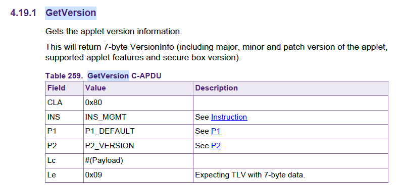

genygbo
Hello Kan,
Please also find the T=1 block frame values for "Get version" below:
5A 20 08 8004002002410709 7306
Should I send any other values additional to this ?
Many Thanks,
Elshadai
14,709件の閲覧回数
Kan_Li
Hi Elshadai,
Thanks for the information! I can recognize Get Version command from the  “80040020", but what is the following "024107" for? From my understanding, this command should be "8004002009" according to the spec.
Kan

genygbo
Thanks for the clarification. I corrected my C-APDU commands as follows:
// for Version Info
uint8_t versionPacket[10] = {0x5A, // NAD
                             0x20, // PCB
                             0x05, // LEN
                             0x80, // CLA
                             0x04, // INS
                             0x00, // P1
                             0x20, // P2
                                   // Lc-?
                             0x09, // Le
                             0x66, // CRC1
                             0xAA  // CRC2 };‍‍‍‍‍‍‍‍‍‍‍‍‍‍‍‍‍‍‍‍‍‍‍‍‍
I have 2 questions:
Really appreciate your help. Thanks!
14,710件の閲覧回数
Kan_Li
Hi Elshadai,
Hope that helps,
Kan
14,709件の閲覧回数
genygbo
Hi Kan,
Thanks a lot for the clarification. I was missing the part of applet selection. I've included it and now, I'm able to get the R-APDU body.
Have a nice day !
Elshadai
