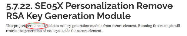

Hey @Kan_Li
I am not able to generate RSA keys with pkcs11 engine, after doing some digging I found that
se05x_Perso_Delete_Mod_RSAKeyGen example removes ability to generate RSA keys.
I have another se05x enabled device and RSA key generation works fine on that.
So is there any way to re-enable RSA key generation?

Hi @bug_squasher_77 ,
I am sorry, but it is not possible to re-enable this module after you run the demo of se05x_Perso_Delete_Mod_RSAKeyGen , as specified in the user manual.
You have to replace that sample with a new one in that case.
Hope that makes sense,
Kan
