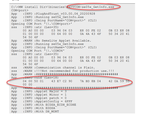

Hello to everyone, there's any chance to retrieve the UUID / Serial Number from an SE050?

Hi @WorkerEmbedded ,
Running the demo of se05x_Getinfo can fetch the uuid out of SE050, please kindly refer to the following for details.
You may refer to https://www.nxp.com/docs/en/application-note/AN12398.pdf for more details.
Hope that helps,
Kan
