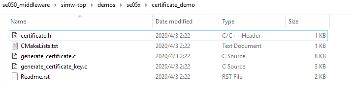

Hello @antonio_mendes ,
We provide a self-signed certificate demo in the latest MW, please kindly refer to the following for details.
Hope that helps,
Kan
