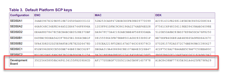

I have a microcontroller(msp430) and a smartcard(se050), and I am sending APDUs from micro controller to the smartcard using Code Composer Studio on my windows computer.
I am trying to create a secure channel (SCP03) using AES symmetry key. I have created a session using this AES key on the smart card and now to perform mutual authentication I have sent 'INITIALIZE UPDATE' command APDU to smart card
Initialize Update APDU:
80 50 00 00 08 00 00 00 00 00 00 00 00 00
And the response from the card is:
00 00 00 00 00 00 00 00 00 00 00 03 60 7E 25 31 3D BE 63 59 BE 34 AA 4B C0 F2 B9 27 B4
where
00 00 00 00 00 00 00 00 00 00  = Key Diversification Data
00 03 60  = Key information
7E 25 31 3D BE 63 59 BE  = card challenge
34 AA 4B C0 F2 B9 27 B4  = card cryptogram
Now, I want to check if card cryptogram is correct or NOT? For that I need to create secret session keys (S-ENC, S-MAC, S-DEK) and the card cryptogram in order to authenticate the card.
And I am not sure what is the static K-ENC key, my se050 development board (OM-SE050ARD) is using?
I have found a document https://www.nxp.com/docs/en/application-note/AN12436.pdf (page 5), where the list of some static keys for se050ARD is given, but I am not able to verify my card cryptogram using any of these keys.
Also I need to create 'Host Cryptogram' that I need to resend to the smart card in 'EXTERNAL AUTHENTICATE' command.
How can I generate these things in code composer? Are there any C-libraries that I can import in my codes to generate these keys and cryptograms?

Hi @Raza ,
OM-SE050ARD has the keys as shown below:
We have provide MW to support the SCP03 communication, and a porting guide for your reference, please kindly refer to the following links for details.
https://www.nxp.com/webapp/Download?colCode=SE050-PLUG-TRUST-MW
https://www.nxp.com/docs/en/application-note/AN12448.pdf
