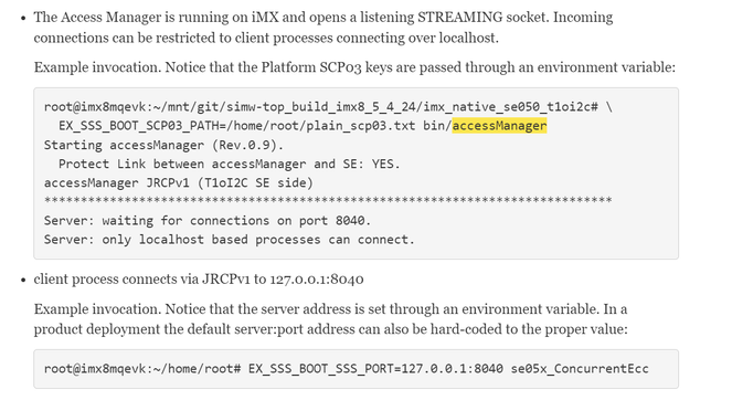

Hi @grzegorz2 ,
Thanks for the information! Would you please specify the procedure of starting the accessManager and haproxy? did you start the accessManager in one console and haproxy in another such as below?
Please kindly clarify. You may refer to "simw-top/doc/hostlib/hostLib/accessManager/doc/accessManager.html" for more details.

grzegorz2
Hi @Kan_Li
I started both applications as linux service and both running in the background. I can also start them in a separate consoles and issue still occurs. I can't see any errors in the output logs, for example:
First console
# EX_SSS_BOOT_SCP03_PATH=/root/config/dynamic/scp_keys /usr/local/bin/accessManager
Using /dev/i2c-1
Starting accessManager (Rev.1.1).
Protect Link between accessManager and SE: YES.
accessManager JRCPv1 (T1oI2C SE side)
Server: waiting for connections.
New client connection. Client ID: 4
Command 0x00 from client 4
DUMMY_ATR=0x00.A0.00.00.03.96.04.03.E8.00.FE.02.0B.03.E8.08.01.00.00.00.00.64.00.00.0A.4A.43.4F.50.34.20.41.54.50.4F.
Replacing *_ATR by default (pre-cooked) ATR.
ATR=0x3B.FB.18.00.00.81.31.FE.45.50.4C.41.43.45.48.4F.4C.44.45.52.AB.
Command 0x01 from client 4
SM_EstablishPlatformSCP03Am (Entry)
App :WARN :Using SCP03 keys from:'/root/config/dynamic/scp_keys' (ENV=EX_SSS_BOOT_SCP03_PATH)
SE050 connected.
SM_EstablishPlatformSCP03Am (Exit); Status = 0x9000
SM_SendAPDUAm: smStatus = 0x9000
Second console
# /usr/local/bin/haproxy -f /tmp/haproxy_dynamic.conf -p /var/service/haproxy/pid -W -S /var/run/haproxy.master
ssse-flw: EmbSe_Init(): Entry
