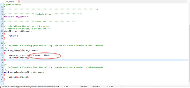

Kan_Li
Hi @krsuresh ,
Thanks for the info! Seems the platformSCP keys used in your test are not for SE052F, would you please configure the keys according to the guide in SE-PLUG-TRUST-MW_04.07.01/simw-top/doc/appendix/platfscp.html?
Hope that helps,
Kan
9,074 Views
krsuresh
Hi @Kan_Li,
Thanks for the update. Yes, the MW is working fine now after configuring the correct PlatformSCP keys. However, I noticed something unusual: the Plug & Trust Nano package samples are also working now without any code changes, even though they were failing earlier. I’m not able to understand how they started working suddenly. Could you please help clarify what might cause this behavior?

I am sorry, but so far there is no response from the MW team due to the holidays, while as a quick solution, you may use a longer timer interval as below:
The source file can be found in nano-package-master/lib/platform/linux/ .

Hi @Kan_Li,
As suggested, I increased the timer interval, but I am still facing the same behavior.

Hi @krsuresh ,
Have you tried a larger value instead? The MW has put this in plan, but the fix I would expect to be the next release.
