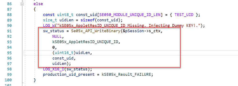

for quick evalution it would be fine to write and read binary files to/from SE050 (to get a whole chain of instructions manually run).
I can´t find any example program or ssscli command to do so.
Is there any program/ssscli command available? If not, could you provide one?

Actually there is an MW example for this function, and you may find it in the demo of "C:\se050_middleware\simw-top\demos\se05x\se05x_Delete_and_test_provision", the code is something as below:
Hope that helps,
Kan

Sorry, my first post was not very precise: I would like to have a example program which I can pass my own binary file to. E.g. like cmd-line parameter.
Is there any?
It would be fine to be able to "play" a whole chain of steps just by example programs (i.e. write data, gen keys, do signing, read, verify). So we could do the whole steps once manually for evaluation.

WriteBinary is e.g. used in ssscli to store a certificate on the SE:
ssscli set cert [keyid] [cert]
on example se05x_InjectCertificate here sss_key_store_set_key is used with the type of an binary (kSSS_CipherType_Binary) which ends up writing it as binary as well:
LOG_I("Injecting ECC certificate at 0x%08X", ecc_object_id);
status =
sss_key_store_set_key(&pCtx->ks, &ecc_cert_object, ecc_cert, sizeof(ecc_cert), sizeof(ecc_cert) * 8, NULL, 0);
On example se05x_delete_and_test_provision the underlying API to write a binary is directly called:
sw_status = Se05x_API_WriteBinary(&pSession->s_ctx,
NULL,
kSE05x_AppletResID_UNIQUE_ID,
0,
(uint16_t)uidLen,
const_uid,
uidLen);
