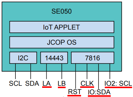

Dear NXP team,
We will use SE050 for our new product.
However, our product does not use ISO7816 and ISO14443 Interfaces.
ISO_14443_LA
ISO_14443_LB
ISO_7816_RST
ISO_7816_CLK
ISO_7816_IO
ISO_7816_IO2
How should these pins be terminated?

Hello George,
If not used, ISO7816 interface tied to VCC and ISO14443 interface tie to GND.
Hope that helps,
Kan

Dear Kan_Li,
Thank you for your quick reply.
Is my understanding correct below?
And is the Pull Up/Down value about 10k-ohm appropriate?
BR,
George
3,965 Views
Kan_Li
Hi George,
Yes, that is ok.
Kan
